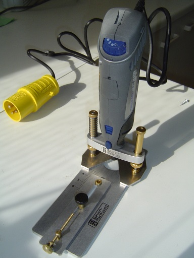

Arnt, yes the UK site transformer is what both Russell and I use. I have a 3kw one that can handle anything I throw at it. Russell has a wiring circuit running from his with the sockets round his shop. You do have to get the plugs for each appliance but they are only about ?1.50 each,you can see one here on my dremel, they are the Rolls Royce of power plugs!

Thanks Colin. Yes, those plugs certainly look sturdy enough!
